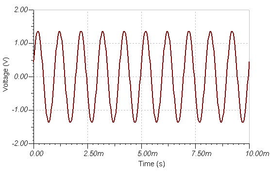

  • Hello
    I did start the sampling of the Fourier series at time=1 and it was still giving the same erronous high distortion reading.
    I did the steady state analysis in transient method, you can see the sine result in the image I Include here.
    Thank
    Bye
    Gaetan
  • Gaetan,
    The waveform doesn't look close to a nice sine wave. Can you post your TINA design (.TSC) here?
    JC

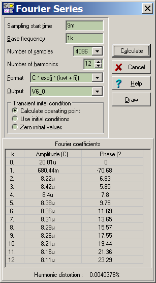

  • Gaetan,
    Thanks for the netlist. I ran a transient for 10ms. As the input frequency is 1KHz, I simply took the last period (from 9ms to 10ms) and calculated the Fourier series on that, which gave me < 0.005% THD on net 6 (where you have VF2 in the schematic. This is with 4096 samples in 1 period, or 12 harmonics:
  • Hello
    My error was that I've use the wrong sampling start time.
    I will use 10ms now on.
    That you
    Bye
    Gaetan
