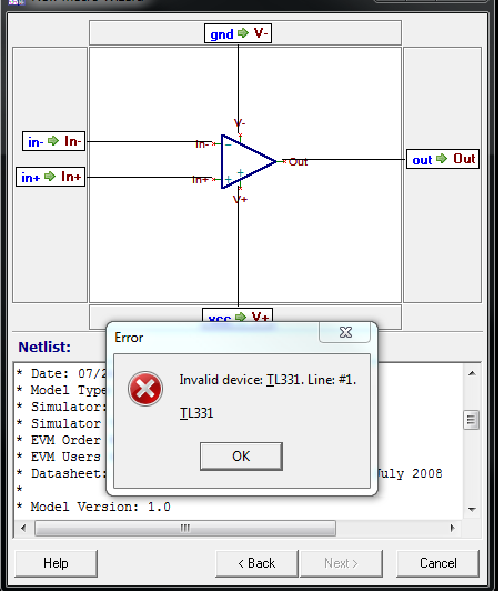

Could I know if TL331 PSpice Model can be applied to TINA?
When I add new Macro in TINA, I encounter some problem. plz see below picture.
Could you help check if the model can be applied to TINA?
Thank you!
Ting
Ting,
Remove the first line of the .lib file. There is an &TL331 in the first line that confuses TINA-TI. Once removed, the .TSM can be created. Please see the attached .TSM file.
