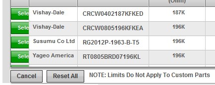

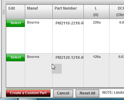

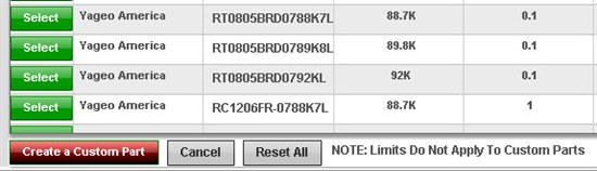

I cannot create a custom part in WEBENCH.  I've tried both Firefox and IE.  Is this feature still available?  Shouldn't there be a button next to CANCEL?
    Yes, the "Create a custom part" feature is still available in WEBENCH.
    Maybe the viewing window was not open fully which prevented the "Create a Custom Part" button from showing.

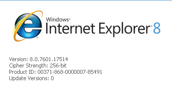

  • What browser and version are you using?  My gut feel is that it is a compatibility issue.
    John Bateson
    I'm using IE8.
    LaRita Gwie
  • I reverted my IE9 back to IE8 - same problem.  I also tried the same on my Macbook with Safari and Firefox.  Same issue.  So I'm guessing that there is something associated with my account that is causing this.  If you could pass this by one of the web developers I would appreciate it.  In the meantime, I'm going to try opening a brand new account to see if that works.

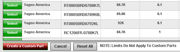

  • The problem is design specific and has nothing to do with the browser, computer, or my account.  If I select a different design, things are as they should be and create custom part appears.
    This is the broken design:
    5706.webench_design_1089656_90_706924539.pdf
    Let me know if there ever is a fix.
    Thanks.
    John Bateson
    SEPIC circuit calculators were developed using standard components only and can't process custom parts which is why the "Create a custom part" button is disabled.  This issue is in the queue to be addressed in the future.
