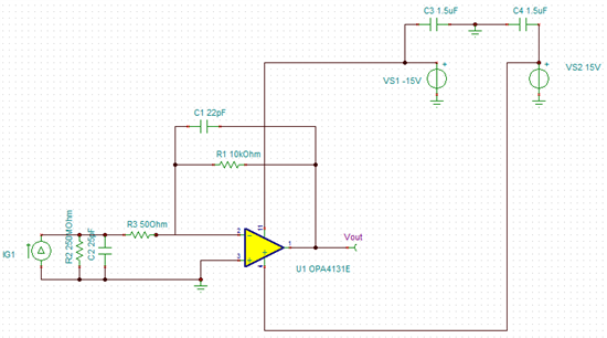

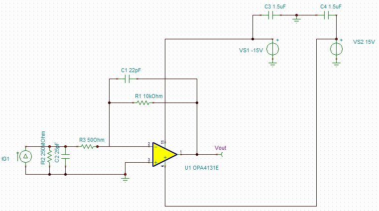

To get familiar with TINA, I put in an old circuit that we made before into TINA. However, when I run the simulation, the graph indicates that it's unstable at 2.30GHz. It doesn't help that an Altium simulation says the circuit is stable and has a different gain. Please Help!
