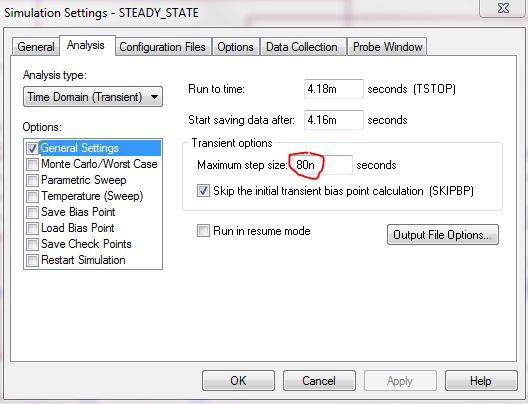

   I'm running TI's PSPICE reference design for the LM5118 steady-state model (Using PSPICE 16), and it's not converging.  I'm not sure how to fix this; any suggestions?

  • Hi Michael,
    What is your VNTOL and ABSTOL settings currently? Can you increase it by a magnitude of 10 each and see if it resolves the problem. If that does not work, can you send us your design files?
  • MichaelH,
    I have confirmed that the reference design works correctly in version 16.2, however, it does not converge in 16.6. I am not sure why the newer version does not work the same as the previous version. In order to get the simulation to run peoperly, please change the Maximum step size from 80n to 20n:
    And set the following options:
    RELTOL from 0.01 to 0.001, Transient time point iteration from 100 to 1000, and check the Use perordering to reduce... box:
    The simulation should now run correctly as it does in 16.2.
    Britt
