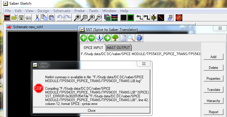

Hello, i got a error message when i translated the TPS54331 from pspice module to saber module. Dose this pspice module can be translated into saber module? Can you send me a saber module of TPS54331? My email is ricky_qinzk@163.com.

The vast majority of the PSpice models for TI Power products located in the product folders are encrypted and can only be used in PSpice version 15.7 or higher. Since you are using Saber, you must have the unencrypted PSpice model. If you have a direct TI support contact, they may request the unencrypted PSpice model for you. Otherwise, please follow the instructions in the following post:
http://e2e.ti.com/support/development_tools/webench_design_center/f/234/t/36943.aspx
