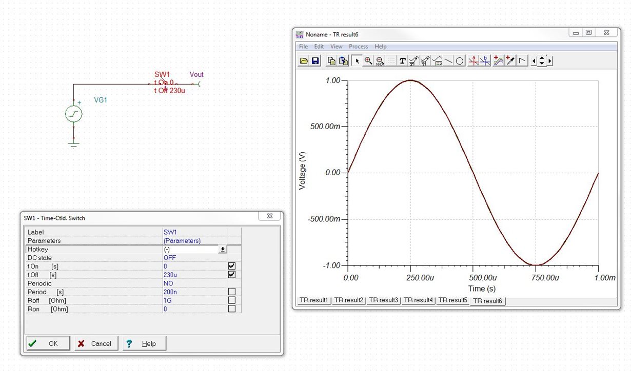

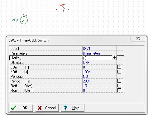

Thanks Britt for the exhaustive answer and my apology for a delay of my reply.
I would like just to choose a delay of a Voltage source Sine Signal. In stead of staring from t=0s I would like to have it start at t1=200ns, for instance.

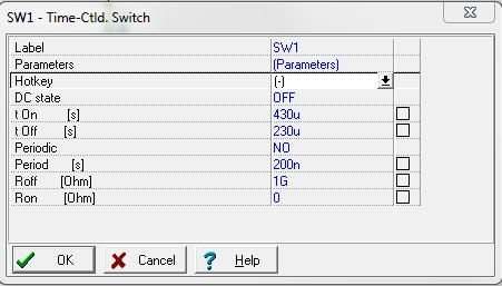

Your third suggestion seems the fastest so I tried it and I could not get it run. Simple test, I want the Sine to be interrupted from 500us to 750us but that does not happen:
or, only with a delay of 200u:
What am I doing wrong?
The other your suggestions are complicated if I want to have a delay of a Sine wave. Am I wrigth?

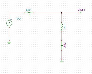

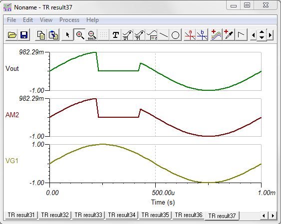

The voltage source will provide enouhg current to supply the 1V waveform regardless of the load. In this case, the switch is the only load, so it appears as if the switch is not present at all. If you add a resistive load to ground after the switch:
The resulting waveform is:
Alternatively, you can connect the switch in parallel with the source and add some source resistance and get the same result. You will have to change the switch configuration to being OFF at DC and turning on at the point you want to delay and turning off at the point you want to pass the waveform again.
