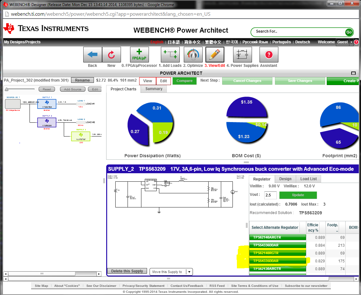

New to Webench. Trying to design a 3 output supply, one output is driven by the rail of one of the other outputs. Wide input range. GEt it all working, go to Build-It-Lite and parts are not available, find substitutes for passives, but basic regular itself is not available.
If I manually search through ti.com and find a regulator that will do the job, I can Webench it, but it is only a single output.
Question: How do I force the regulator of choice (with available parts!) into a multi-output design and allow it to optimize/simulate? The Webench system insists on using an unavailable regulator when a different item can actually do the job and get better efficiency numbers.

  • The part the tool is trying to use is: LMR24210TL/NOPB .
    The part I am trying to force it to use instead of that in this multi-output design is: LM46002, which I can come up with an acceptable design by itself, but I can't seem to get it to come up in a multi-output solution to generate the 3.3V rail which then also feeds a low power 1.8V switcher. I have come up with a 4-switcher solution, but it is far less efficient even with the "knob" all the way to the "efficient" setting.

    Come back to your question about how to force the Power Architect to certain part number. You need to perform this on step #3: "View Project Detail" Edit for the power architect tree. This step will allow you to either change the rail, or change the IC being use for solution by select another IC from the "Select Alternate Regulator". Then when you click "Create Project", The tree will be update and created with the new selected IC.
