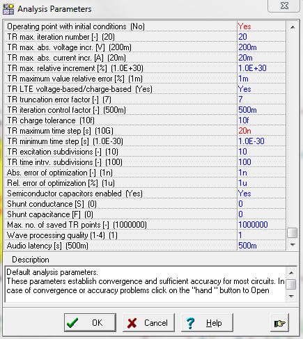

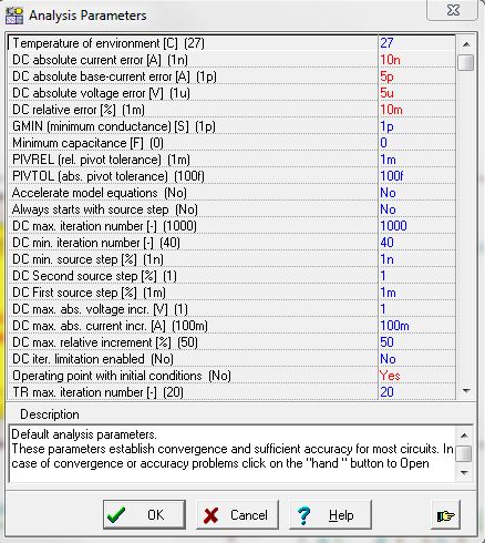

    The first thing I needed to fix was the simulation parameters. They can be seen at ANalysis-->Set Analysis Parameters...
    Anything highlighted in red was changed from the TINA-TI defaults. These values are the same as the reference design. Once these were applied, the device began working. I also changed the FAST variable to 1 (faster simulation than with 0). Next, the resistor was changed to a capacitor (based on the reference design and the fact that the sim was only getting to 1.44V). Then, RLOAD was added (and it is not really that necessary, but it does make the device a little happier from a simulation standpoint. No load is not very realistic with a 30A part...).
