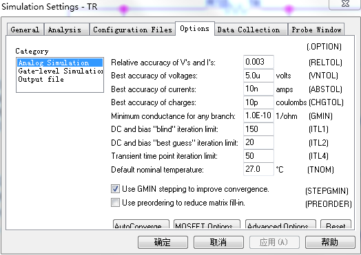

    As i simulate the circuit with the LME29724 Pspice module i download from TI website, an error massage was displayed as below. Is it the problem of the Pspice module? How can i fix it?
Unable to find index file lme49724.ind for library file lme49724.lib
Making new index file lme49724.ind for library file lme49724.lib
Index has 17 entries from 1 file(s).
ERROR -- Node N79726 is floating
ERROR -- Node X_U1.ucm_NET1 is floating

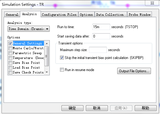

    There is a PDF file named SCHEMATIC1 _ PAGE1 in the folder LME49724 Simulation too, which is the schematic of the project. you can biuld the same schematic if  you still could not open the project. My Simulation Settings is as below.
