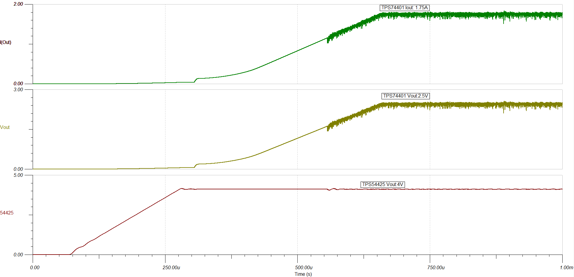

I am trying to simulate the power supply using Tina-Ti. 12V input is applied to TPS54425 DC-DC, its output is 4V. This 4V is the input to TPS74401. Output is 2.5V. At higher loads there is noise in the output of TPS74401. I tried with different load currents, above 500mA load there is noise in the output. SS capacitor of TPS74401, I tried different values. Still no change. Could anyone please comment on this?
 Waveform is attached for your reference. SS capacitor used is 300pF.
