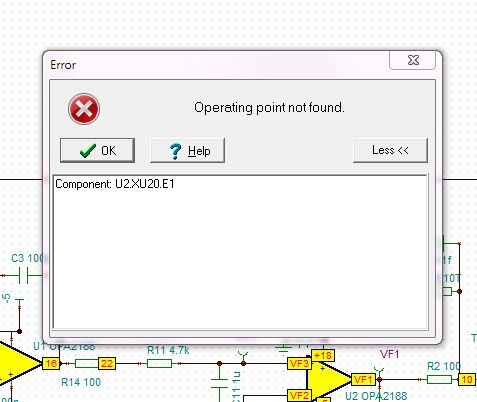

Operating point not found OPA2188
Other Parts Discussed in Thread: LM358, OPA2188, TINA-TI, INA282, INA213, LM324, INA226
I am new in simulation, my first try is with Tina.
I use a lot of TI parts so this is the most comfortable.
I have difficulties in my beta project.
This is a modular current generator.
If I put LM358 in the place of opamps I can make AC, DC, transient analysis.
If I change to OPA2188 doesn't work.
(I tried to attach the files but it looks the editor is inserting. Where I can attach file?)
How can I interpret the error message.

    How did you change to the OPA2188? Did you download the model from the product folder and insert the .TSM file using Insert-->Macro?
    I simply pulled the OPA2188 reference design in TINA-TI and copied the OPA2188 into your schematic and it worked fine (Be careful to make sure that you have all of the connections correct before simulating. To copy the device, simply select it and use crtl-C and then place it in the new schematic with crtl-V.

    I have downloaded from TI website a zip file containing  TSM, TLD, LIB files, copied into the TINA Spice folder and recompiled the library from the tools menu. It was working at the beginning, but later as I built the additional details of the circuit it worked less and less. After I closed the feedback it  has stopped.
    Still doesn't work what you sent. The DC Anal works, the Transient works if I check the "Use initial condition" or "Zero initial values" at Analysis start.
    AC Analysis, and other options endig with error message I have attached.

    There are a few things I need to clarify. The first is with a DC simulation. Why would you run a DC simulation on an AC or Transient model? The DC simulation of a time or frequency based circuit is relatively uninteresting unless you are looking to see if your power supplies are biased correctly (or perhaps a voltage divider being used).
    The .TSC file in the OPA2188 product folder (Reference Design) appears to work correctly for AC and transient simulations. I am not sure why your simulation does not work in the AC simulation. In the transient simulation, the use/zero initial conditions option skips the DC bias point calculation (which appears to be failing for the AC case). This DC bias point calculation is simply a starting point for the matrix before the first time point is calculated. In some cases, the simulator will generate a starting point that is not close enough to have the matrix solved based on the simulation parameters specified. This is why the options exist.
    You might want to check the analysis parameters from the reference design for the OPA2188 and use those to see if the issue will be resolved.

  • Hi Britt,
    The copy of parameters worked. Now the OPA2188 simulation is fine. Thanks.
    Then I had fault with LM358 simulation, but since I had changed it to LM324 it works flawless!
