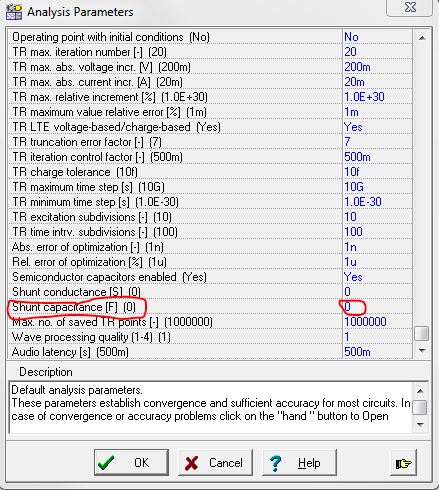

I am getting a consistent error message (Irregular circuit) when trying to run a simulation (DC, AC or Transient analysis). I've deleted the component in question and re-created it and re-wired it but nothing seems to work to get rid of the error. What am I doing wrong?

    An irregular circuit in TINA-TI usually means that there is a node that does not have a direct path to ground. For example, TINA-TI will flag two capacitors in series as an irregular circuit since the node between them does not have a path to ground. However, this is due to the default in TINA-TI for shunt capacitance. You can change this value in the Set Analysis Parameters (Analysis-->Set Analysis Parameters...). Click on the Hand icone and select View All. Scroll to the bottom and change the Shunt Capcitance to 1p. This may help with the issue.

    Thanks for the reply. I appreciate it. I tried your suggestion including changing the shunt conductances to 1uOhm. I still get the same errors. I've uploaded the file here (I think if it worked properly) so that you can have a look at it. Thanks for the help.

    Take a look at this circuit. I have added a shunt conductance of 1f.
    I do not use the Insert-->Output for monitoring. I recommend using the meters. In this case, I am using voltage pins to measure the voltage at the two locations. If you want a differential voltage, you can use the Voltmeter. The voltage pins refer to ground all of the time.
