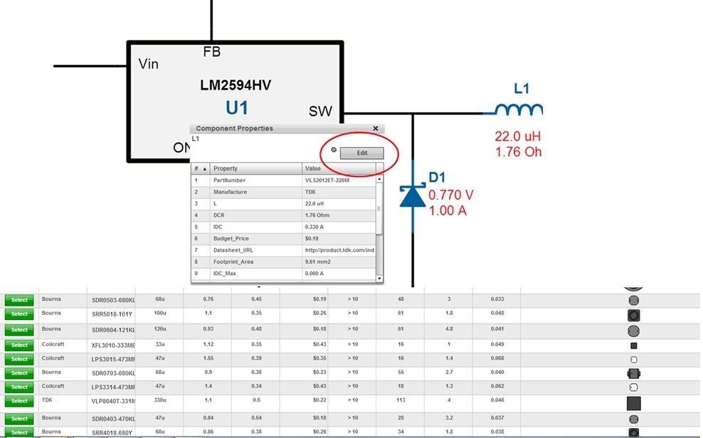

Webbench seems to be making wrong inductor calculations, at least for LM2594.
48V input, 12V output at 0.200 A..    select LM2594HV-12 solution.  It recommends 22uH.
However this value is way too low.  The data sheet chart figure 23 shows it should be 330uH.
