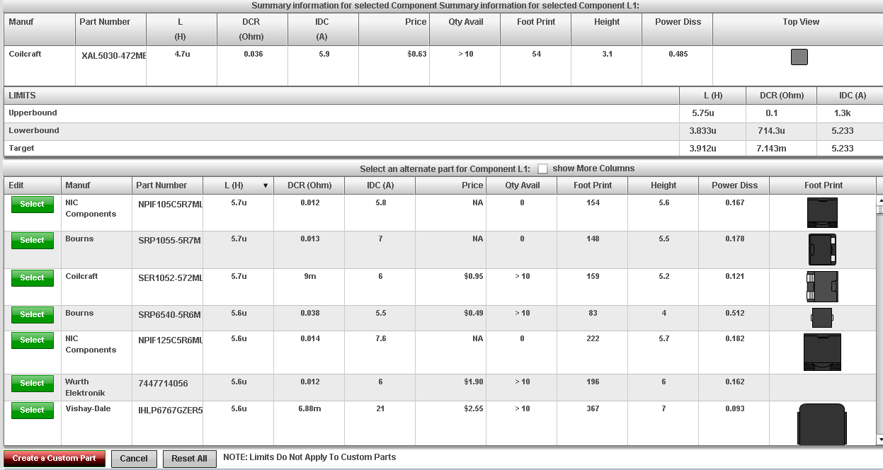

Hi I am designing a 5V 3A DC-DC converter using TPS54332. Input will be 24V. Web bench has recommended me following values but this value components are not available locally. So i am replacing them with nearest standard values can can any one verify weather circuit will properly or not? Following are the values
Rcomp 66.5 kOhm replacing it with 67K
Rfbb 1.96 kOhm replacing with 2K
Rfbt 10.2KOhm replacing it with 10K
Ccomp 430pF replacing it with 470pF
Diode VF@Io= 700.0 mV VRRM= 60.0 V replacing with 800mV 80V diode. (s5310)
and power inductor of 5uH

  • Hi Suyog,
    You can change the components in the BOM view. Click on the BOM button in the top navigation bar, and click ‘Select Alternate Part’ beside the component you want to change
    You will see a list of alternate parts. If you see a suitable component, click on the ‘Select’ button beside the component to use it in your design.
    If you do not find your desired component in the list, click on the red ‘Create a Custom Part’ button on the bottom left of the ‘Alternate Parts’ page to specify the details of your custom component.
    When you replace a component in your design, the ‘Operating Values’ table is updated to reflect the design with the new components, so you can see how the components affected the phase margin, crossover, inductor ripple, and other values.
    Please give the above a try and let us know if you have more questions.
    Kris
  • I workes. Now its calculating that my output will be 4.8V this looks promising. Will go ahead with prototype and update you on its performance.
