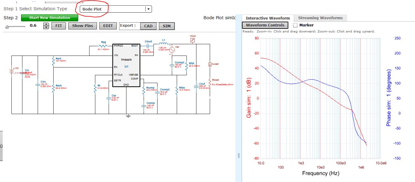

  • Oops apparently the editor can't handle pasting a picture even though it looked ok when editing. Here it is, uploaded:
    I also tried opening the original TPS54478 webench design and there I do have a drop down menu with Bode as a choice. Strange, all my edits were plain passive components from your lists. Also a bit strange that I have the tab "Parameters" (with .TRAN parameters) but no such tab in original design.

  • David,
    You used the Schematic Editor for your edits. If you click on the Edit button as shown in the previous post, you will get a window to ask to create a copy of the design before proceeding. If you click OK, the Schematic Editor is invoked and you design will show the Custom Design tag (in your picture, upper left corner). This takes you into the full simulator interface where you can change the topology of the circuit, add passive and active components and do some interesting manipulations as you would in a full simulator.
    If you only want to change the values of components, start from the original design from the product folder where you input your conditions. Once the design is created, go to the schematic page and right click on the component you wish to change and select an alternate component (or you can do this from the BOM page as I showed previously). Once a component is changes, the OpVals and charts are updated and you can see the impact quickly on your perfromance. Once all of the updates are made, you can then run the simulation (Bode Plot, etc.) to verify your changes.
    Both the Schematic Editor and WEBENCH® Power Designer use the same inteface for pasive component changes. If you do not use the Schematic Editor button, I believe you will be able to do want you want and see the results you were trying to obtain.
