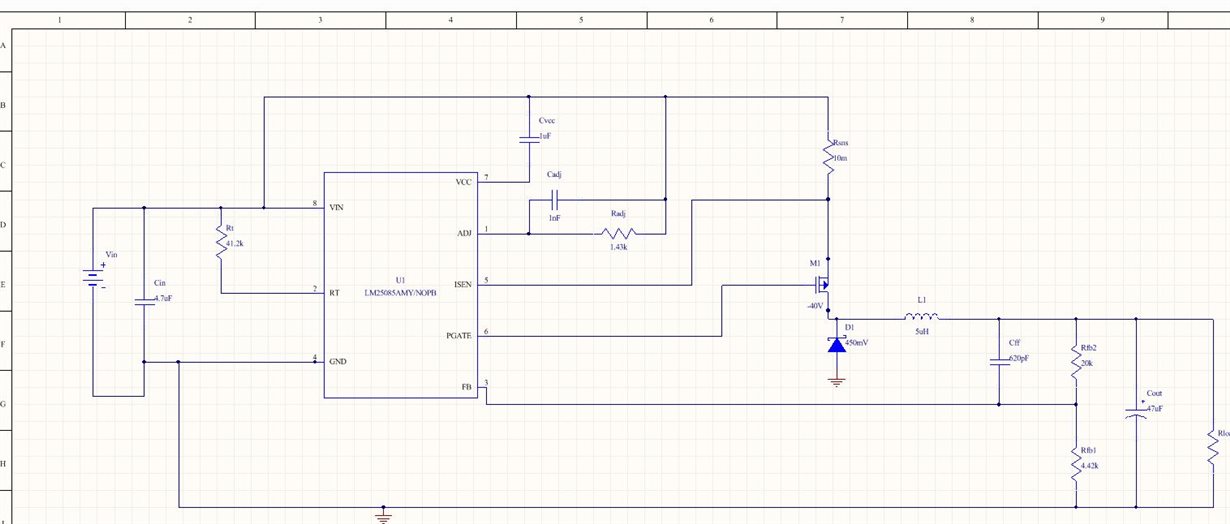

The schematic produced from the TI Webench Designer for the LM25085A Switching Regulator is different from its application schematic in the datasheet.  Specifically, the Webench Designer schematic has mislabeled pin names as well as different connections for the ISEN/PGATE compared to the datasheet schematic.  Please compare the two and note GND & FB pins, the VIN, VCC & ADJ pin, and the ISEN & PGATE pins.  All of those pin names are different on the Datasheet.  Next notice where the PGATE and ISEN pins connect to on each schematic.  I assume the datasheet is correct and the Webench is wrong.  Please verify this information.  If you need anything else please feel free to contact me via email or phone: 716-312-0088.
