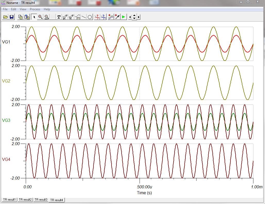

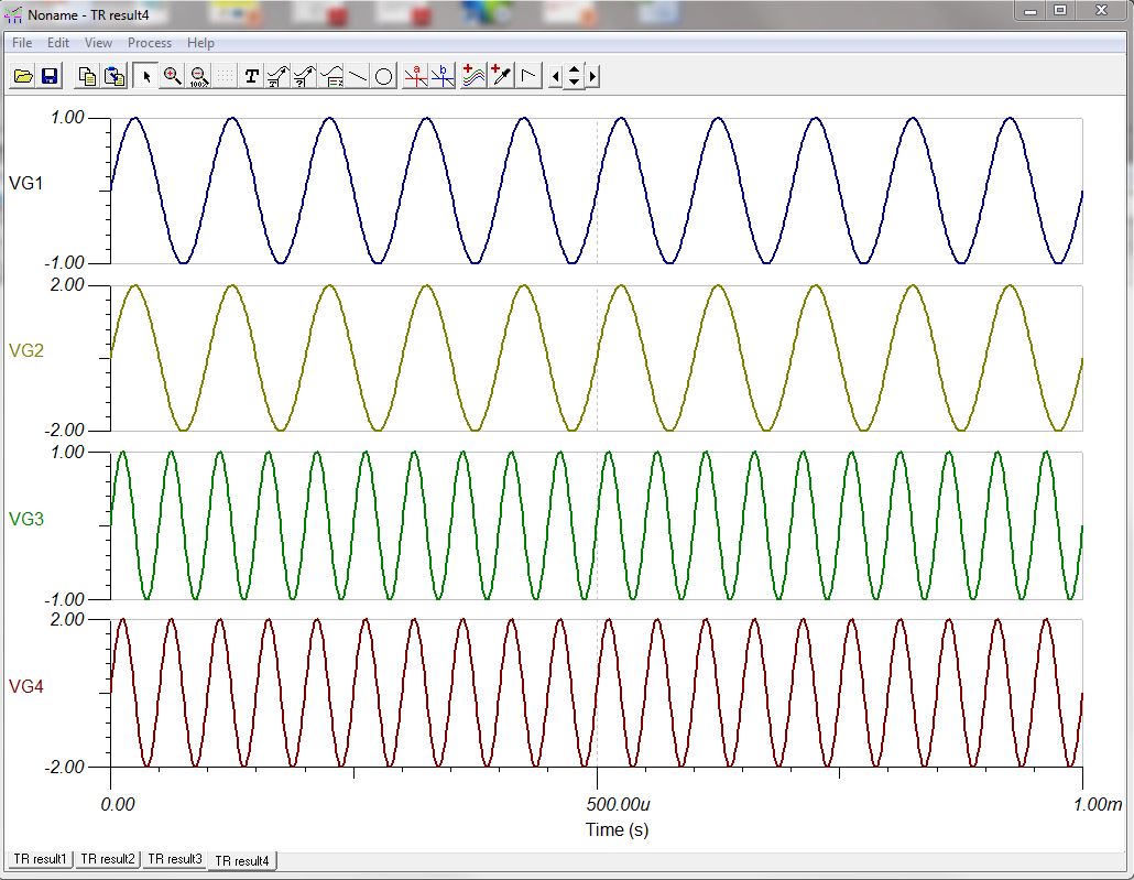

    Original plot with 4 waveforms after selecting separate curves. To automatically select separate curves, simply add a : to the name of one of your outputs.

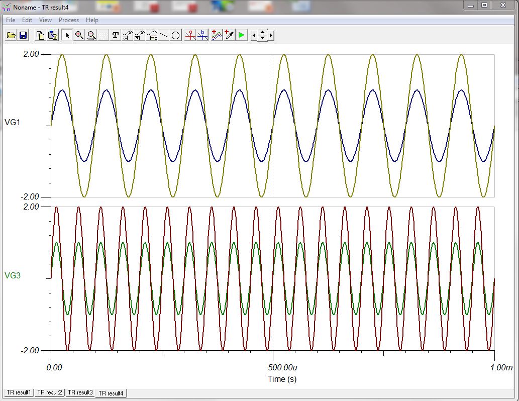

    Next, cut and paste the waveforms for custom grouping:
    Next, delete the original signals that were pasted:

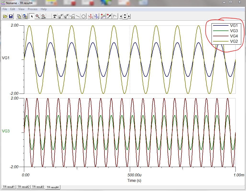

    Now, add the legend since the Y axis labels are not correct:
    Update the axis:

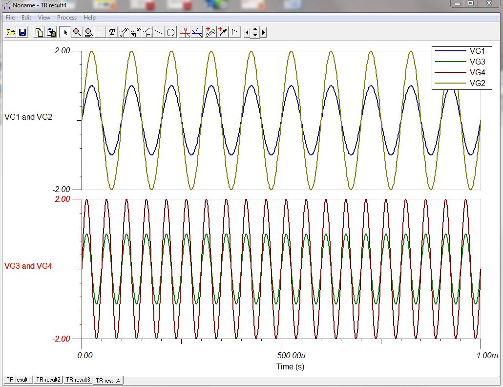

    And your custom plot is done. However, when you re-run the simulation, this will revert to the original format of the 4 waveforms (separated or collected, depending on how you first got the waveforms). You would have to do this each time you wanted to make the plot. You can always go back to the previous plot using the tab at the bottom of the diagram window and it will remain the same.
