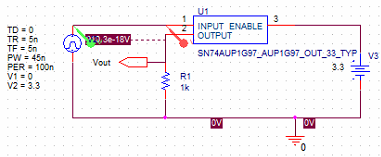

I want to simulate the model sn74aup1g97 with pspice.
I converted the .ibs file of sn74aup1g97 and insert it like the picture below.

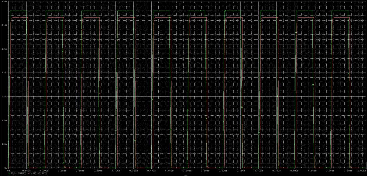

And simulation result is like above.
I want to get the inverter waveform as like figure 8 in the datasheet.
however, i don't know how to use this simulation model as an inverter.
I want to ask some advices
  • Hi WooJin,
    IBIS doesn't support modeling of the internal behavior of the device. It is strictly for modeling the Input and Output buffer behavior. If you wanted to model the internal behavior, you could add an ideal inverter before the IBIS model. That way, you'd be able to model the buffer output properly, and the state as well.
