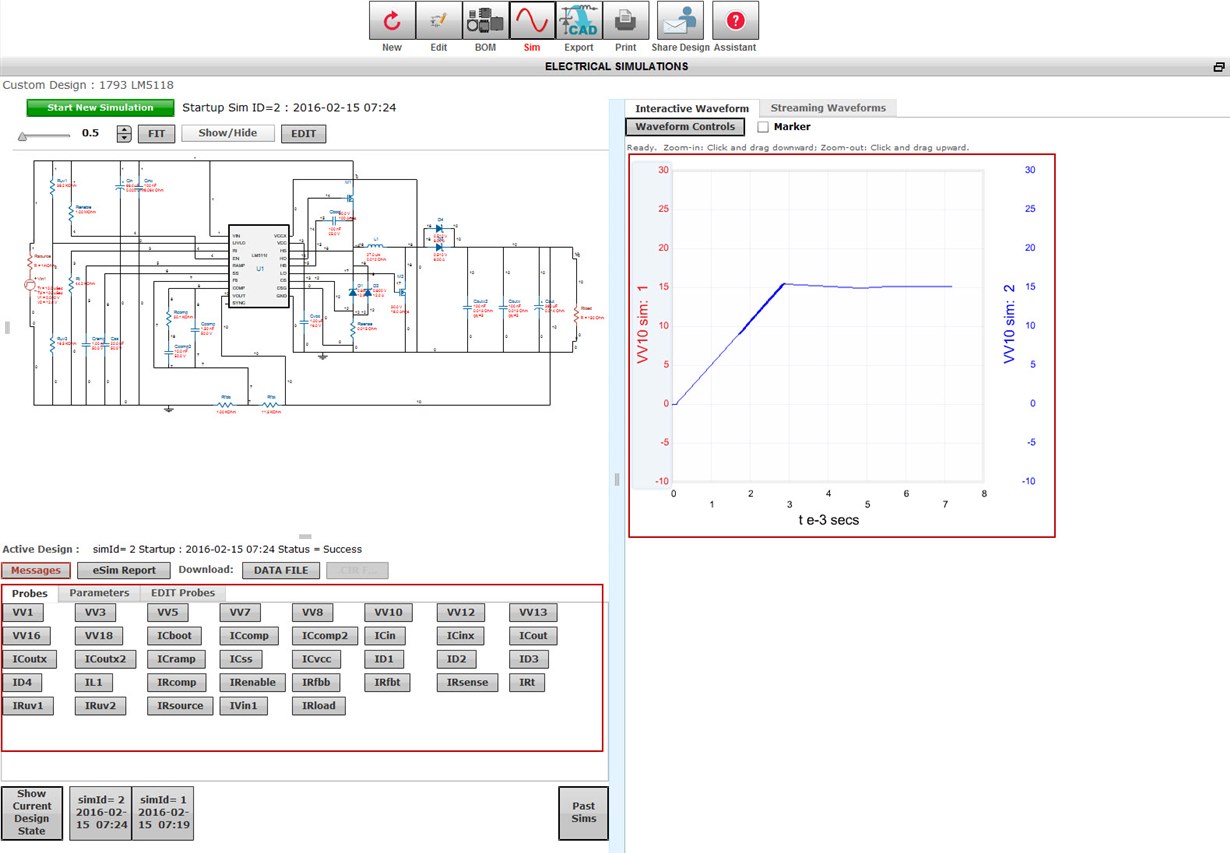

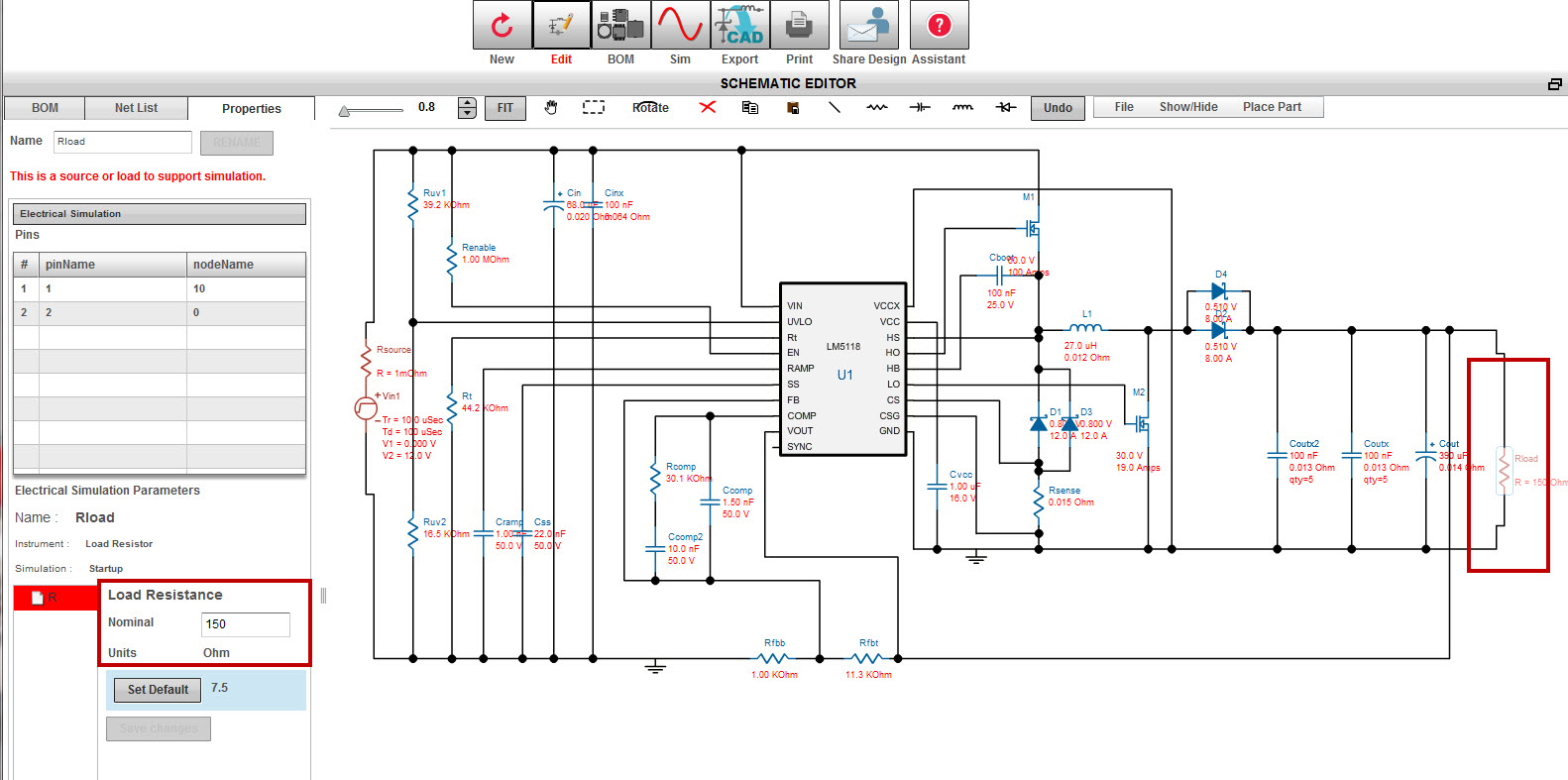

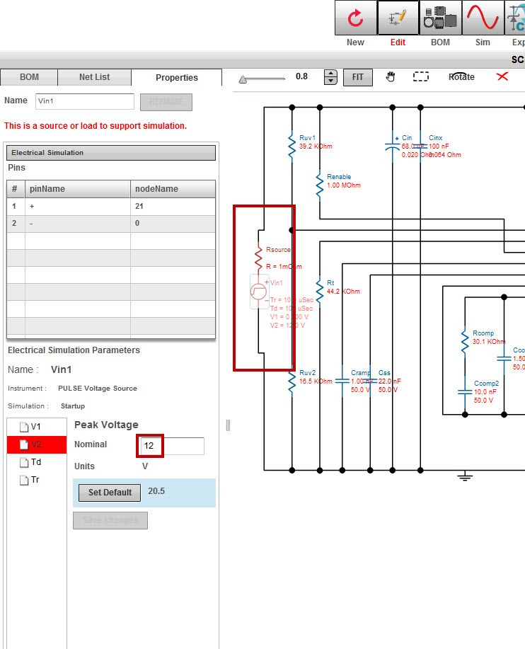

    We will investigate the behavior of the dv/dt panel. As a short term solution, you could use the Schematic Editor and run a startup simulation with your required values. Click on the Edit icon and select the green "Edit this design" button on the lower left hand side of the pop up window. This will create a copy of the WEBENCH® generated design in the Schematic Editor (Startup simulation only, no CC functions supported). Click on the Vin1 input and change it to 12V.
    Next, click on the Load (Rload) and change it to 150Ohms (for the 100mA case).
    Click on the simulation button (the red sine wave) and run the simulation. You can look at any of the results using the probe list or by simply clicking on the node or component in the schematic.
    You can now update Vin to 24V and re-run the simulation. Please remember that this is a simulation only interface. You can always return to the original design by using the MyDesigns link in the WEBENCH® window (upper left hand corner).
