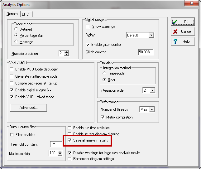

    In order to be able to display all of the nodes in the circuit, enter the Analysis-->Options menu. Make sure that the Save all analysis results box is checked:

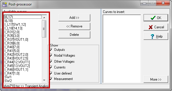

    Next, run the transient simulation. It is set up to run for 900uS. Once the simulation is complete, you may choose any of the nodes for display in the Diagram window by clicking on the Post processor button:
    A full list should be on the left hand side of the window. You can also use the probe and touch the node or component to set the curve to be displayed
    Simply click on the name in the left hand window, click the Add>> button and hit OK. That waveform will be added to the Diagram window. If you click with the probe, the waveform you clicked will be highlighted in the left hand window. Click the Add>> button and click on OK.

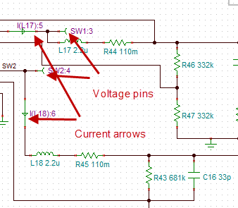

    You can also add current arrows or voltage meters to the circuit and the curves will be automatically displayed when the simulation is completed.
