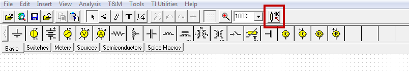

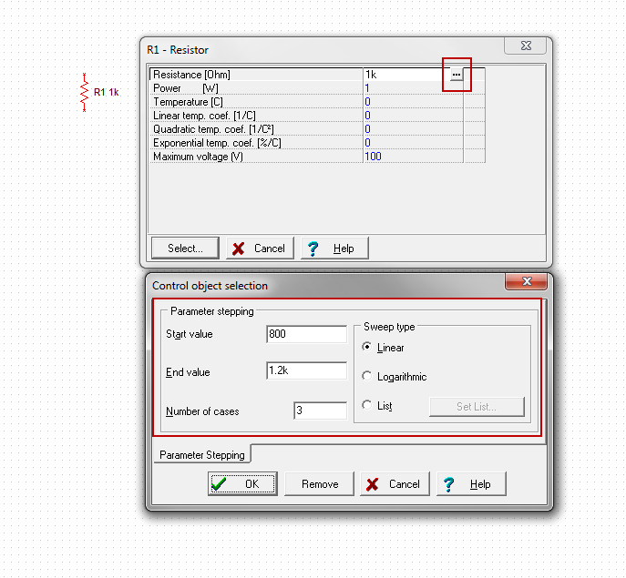

  • Krzysztof,
    Does it have to vary with a sin wave? You can run the simulation with multiple values using the Control object in TINA-TI, but this is multiple simulations with different values for R15. Use the Select Control Object:
    The cursor will change and you select the resistor with it. Click on the ellipsis and fill in the resistance values by list or sweep. Click on OK and an asterisk will appear next to the resistor value.
    Run the simulation and each sim will use a different value of the resistor. The simulations will all appear in the Diagram Window when completed. The legend can be used to show you the multiple curves.
