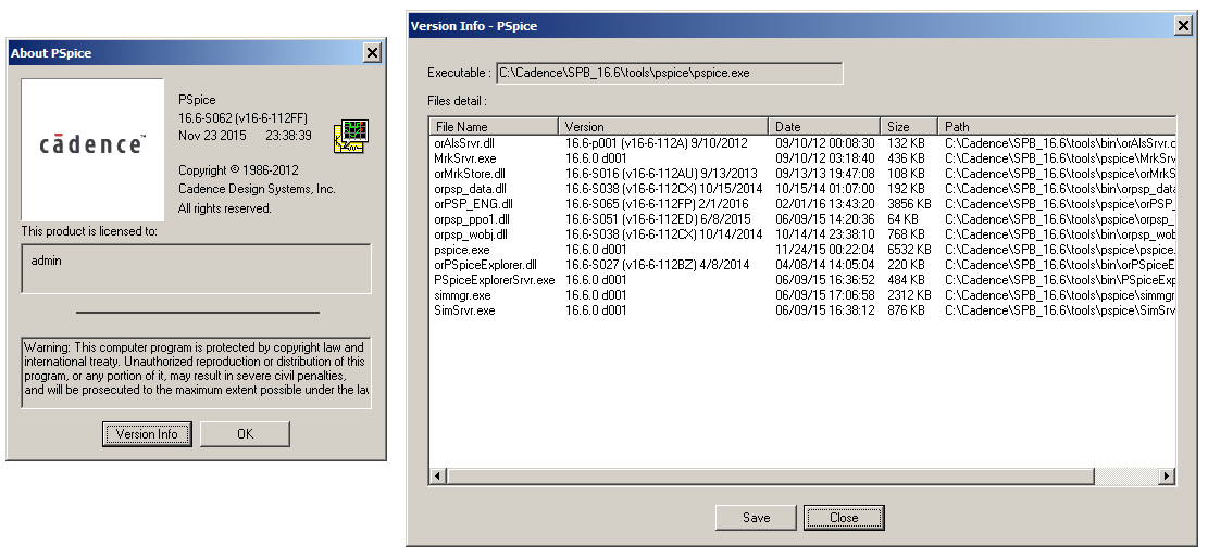

    Thanks for your investigation. I also send my test bench to the Cadence support and they experience the same issue as me: long convergence time and wrong results. They are asking about your OrCAD version details like the picture here under. In PSpice --> Help --> about PSpice --> version info. They also ask if it would be possible to give us your pspice.ini file?

  • Etienne,
    The version info is below. Pspice is the simulation engine behind Allegro.
  • Apologies Etienne. Our system removed the images in my last reply.
    The version info should show up this time.
    The tool is Allegro, and it uses Pspice as the sim engine.
  • Hello John,
    Thanks for your information.
    The Cadence support discover that the problem is on the simulator side. They try with version 16.6-S027 like you and see that it works well like for you, and then see that they have convergence issues with the next versions of the simulator. So now, the problem is in the hand of Cadence.
