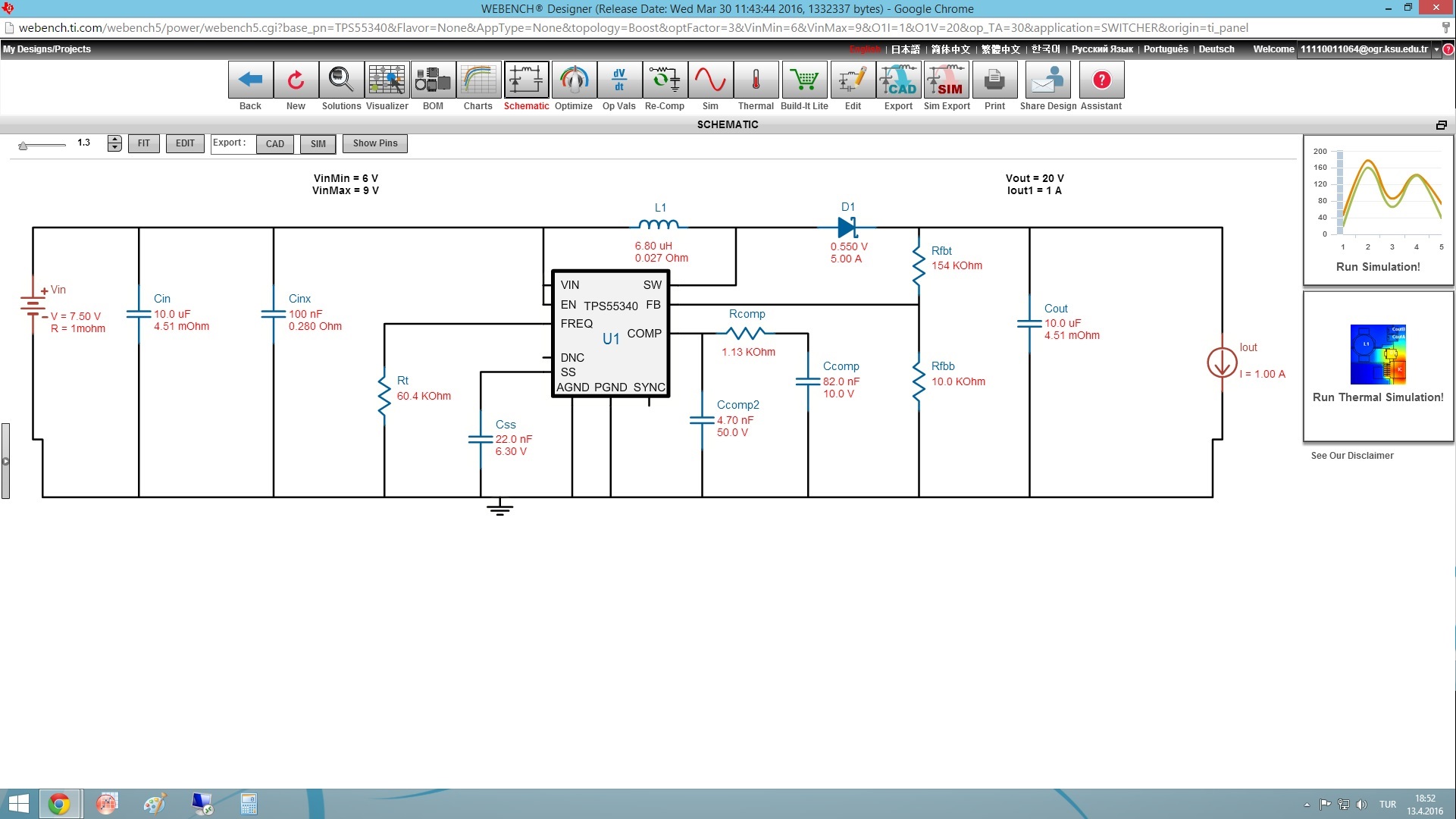

TPS55340 does not boost
I have a Power Source:7.4 Volt, Lithium Battery
I need to reach to 20 Volt, 1 Ampere on 20 ohm load resistance.
I tried circuit on WEBENCH but it didn't work.
How can I solve the problem? What is your opinion?
  • Hi Beytullah,
    Thank you for using WEBENCH. Have you used the exact BOM as recommended by the design? Can you please share the layout with us?
    Pavani Jella
    WEBENCH Applications
  • Beytullah,
    In addition to what Pavani asked, what do you mean by the circuit did not work? Do you mean that it failed in WEBENCH® or did you build the design and the design failed after it was constructed?
    If the device failed in WEBENCH®, please let us know how and what it failed.
    If the circuit failed after construction, did you use the board layout that was exported from WEBENCH®? Does the Lithium battery have enough output current to drive the SMPS at a little over 3.5A?
