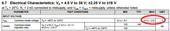

I'm running this model  (the LIB file downloaded from the tools area on the product page www.ti.com/.../toolssoftware )  in LTspice. I'm powering between 5V and ground, and the op amp is wired as a simple follower.  the input is a 1V sin wave at 10 Hz.  I started with a 2.5V offset on the input, and then moved down to a 1V offset as the output was saturated at about 2.4 V.  It worked just fine with a 1V offset.  Can someone maybe check the model for this rail to rail op amp?
I know the model must be wrong, but the spurious run is shaking my confidence a bit.

    First, I presume you refer to a quad version of OPA140 thus OPA4140, and not OPA41040. The OPA140 macro-model is correct BUT you violate the input common-mode voltage range. OPA4140 has rail-to-rail output voltage range but NOT the input. See the datasheet table below: on 5V single supply, the linear range of the input signal extends only from -0.1V to 1.5V while you are applying signal from 1.5V to 3.5V thus violating the allowable range by as much as 2V.
  • Thanks!  Should have checked first.  Since I was running around 2.5V, I just assumed I'd be in the clear.
