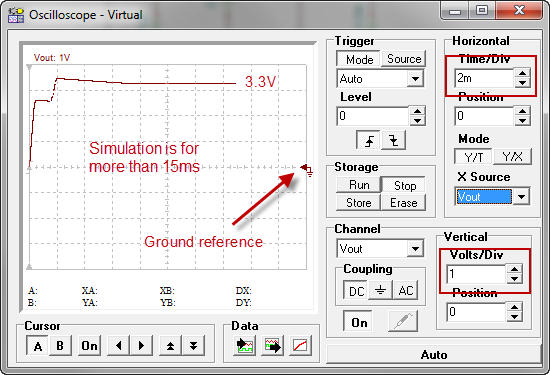

Petuker,
The simulation appears to be working with the oscilloscope when I use it. I would use a much larger time step, however since the simulation needs to run for quite some time before settling down:
If you run it with the 200us time that you were using, the line just looks flat, but it does go to 3.3V after 15ms of simulation time.
