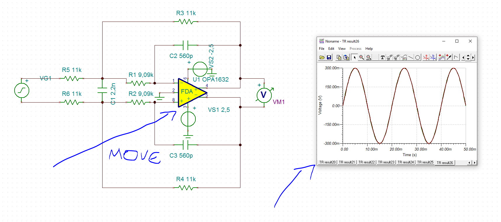

It seems that there is a simulation bug in TINA-TI that is messing with the results.
I was simulating a MFB Filter using OPA1632 and noticed that sometimes the signal phase shifted. I've noticed also that the bug is totally repeatable. I am using version 9.3.150.4 SF-TI. Attached is the circuit I am using.
If I delete U1 and add another OPA1632, the phase get shifted (180 degrees). If I do a Ctrl+X on U1 and paste it in another place, than move to the correct place, the phase shift back to normal.
The correct behavior should be the second one, when both signals are in phase (confirmed using TI Filter Pro and another Spice program).
Is this correct or am I doing something wrong?

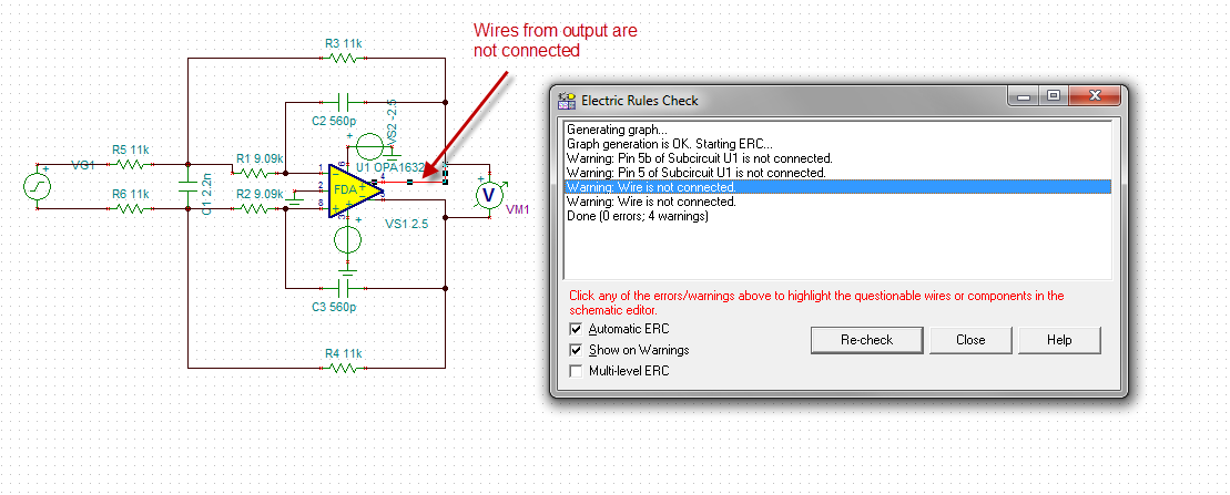

  • Guilherme,
    When I open your .TSC file, I get the following errors when I run an ERC:
    So, when you are cut and pasting the device, the wires from the output are NOT connecting again and you are seeing the input signal without being processed through the amplifier. If you connect the wires up, you get the original simulation. If you run the original simulation with the output disconnected, you will get the two signals overlaid as you showed in your post.
    We will have to look into why the phase shift occurs in the simulation. I don't have an answer for that currently.
  • Hello Guilherme,
      I confirmed Britt's findings with regards to the unconnected output. Also, a Fully Differential Amplifier (FDA) is inherently inverting. Please see this document for a more in-depth explanation of FDAs.

    About TINA-TI, my mistake. I thought that the wires would connect themselves as soon as I moved the component. Didn't realize that the wires were bigger (I was testing with THS4120 which have slightly smaller output pins).
