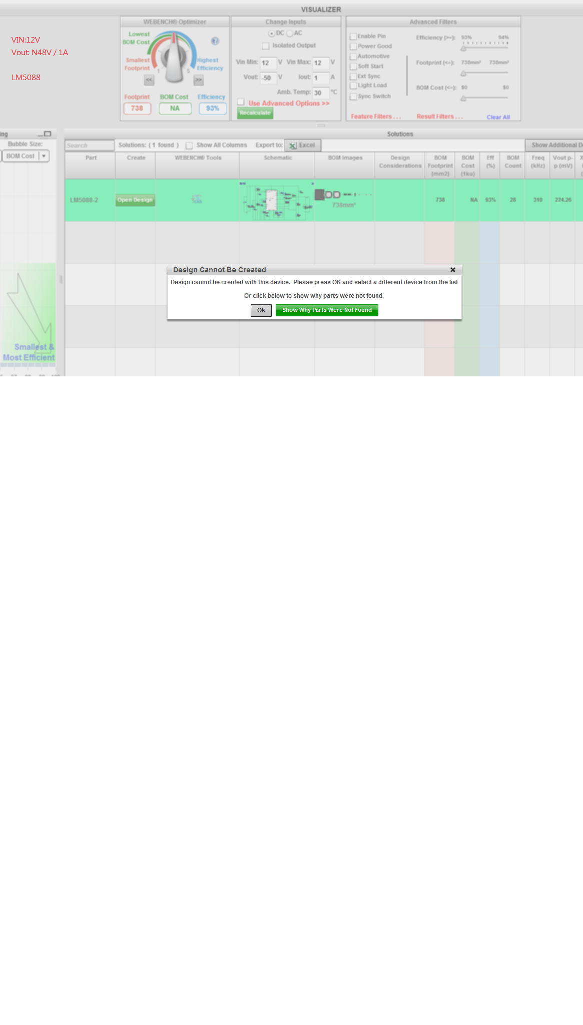

Hi!
        I want to simulate LM5088 from Vin 12V to Vout N48v 1A, webench simulate provide solution but  can't provide reference design.
Could someone help me ? or provide the better solutions Vin 12V to Vout N48v 1A.
tks.
              kuda
https://webench.ti.com/webench5/power/webench5.cgi?VinMin=24&VinMax=24&O1V=-50&O1I=1&base_pn=LM5116&AppType=None&op_TA=30&lang_chosen=en_US&origin=pf_panel&optfactor=3
  • kuda,
    Unfortunately, most of the PSpice models cannot be used in an Inverting configuration, due to the way the model was created. The device will still function properly, however, the simulation cannot be performed using the PSpice model. In WEBENCH® Power Designer, the device has to have the inverting configuration for the circuit calculator in order for the design to be created.
    I will check with the developer for the LM5088 to see if the inverting configuration can be supported.
