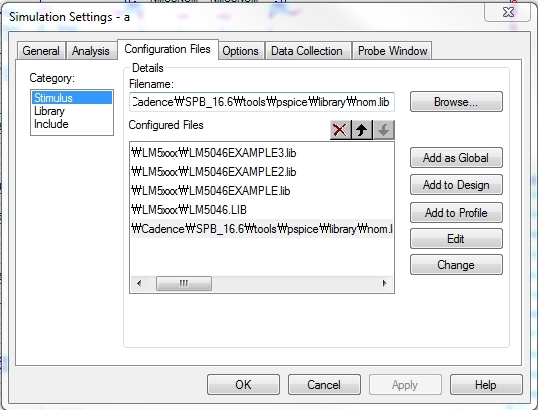

  • Hello Britt,
    Thank you for your answer.
    I've tryied to run the model that you shared, but, it also didn't work.
    It looks have some library problem, but I can't modify it.
    regarding converting the design to TINA, it also showed error on New Macro Wizard.
    (Missing syntax element. Line:#347. XDFF1 DFF2 DFF3 DFF4 DFF5 RSFF5K PARAMS:)
    If you can convert PSPICE model to TINA, please share the converted TINA model.
    following is the error message.

  • Britt,
    the lib was already added as following capture but it also showed error. (ERROR(ORPSIM-15108): Subcircuit TX1P2S used by X_U7 is undefined)
    When changed the example3.lib to original one, it also can't run the simulation.
    Following is the error message. Would you please let me know why the model can't run?

  • Jerome,
    You seem to be having a lot of difficulty with the PSpice symbol files and how they are set up. Please try the following .zip file that I have created for PSpice version 16.6. Unzip the files and run the opj file and it should run for you. It has been tested in 16.6 and works correctly. You should not have to change anything.
    2235.LM5046_Example.zip
  • Hi Britt,
    Thank you very much.
    I've checked your modified mode is working well.
    Thanks and Best Regards.
    Jerome Shin
