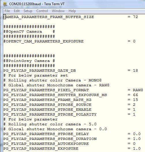

3. We copied the calibration data from PC to AM572x file system and tried to run 7 directly, but we met below error. Would you pls kindly give your suggestion? You can find detail log at
