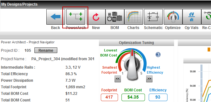

  • Sebastien,
    I do not know of an easy way change the regulator after you have created the project. There are several places to change the regulators before submitting the project, but I am not familiar with a was to do this without re-creating your project. To re-create your project using the same conditions as your existing project, simply load the existing project by clicking on the My Designs/Projects link at the upper left of the WEBENCH® window:
    Next, choose your project and open it:
    Click on the PowerArch icon:
    Select the Start New Project button (right hand side of the window). Once you have started the new project, you can update any of your loads as needed. If no changes are needed, click on the Submit Project Requirements (green button) and begin the new project.
    If the project is relatively new, you will probably see the original solution that you chose. You can then customize it in the View Project Details section and change out the regulators that you want to update. Please note that if the project is older, better solutions may now exist and be recommended in the tool for individual rails or for the entire project. Once you have selected the IC's that your want, you can then click on Create Project to further explore the solutions chosen. Once you have used the Create Project, you will not be able to change the IC's for the individual power supplies developed.
