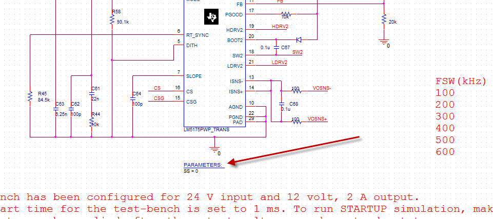

I just started working on a 4 switch buck-boost converter using the LM5175. I got the encrypted PSpice transient model OK and I imported the model into Orcad OK using Capture CIS. When I run a transient simulation I get a few warnings and an error in PSpice:

ERROR(ORPSIM-15167): Undefined parameter: SS.
Any ideas on how to fix this? At this point I have the model connected as it is in the suggested Webench schematic. From there I was going to modify it, but I can't get it to run.

    Have you ever added a PARAMETERS block to your schematic? Here is what the reference design looks like from the product folder:
    To add the parameter block, simply click on the Place Part icon and search for PARAM. Place the block and enter the parameter name as SS and the value as 0 (for startup) or 1 (for steady state). The reference designs (steady state and startup) run correctly when I open it up.

  • Thanks Britt. Simple mistake on my part, I had missed the PARAM block. It's simulating OK now.
