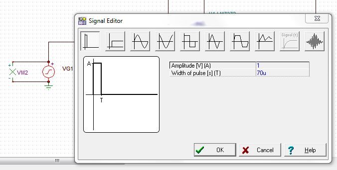

I'm trying to set up an input pulse, here are my settings:

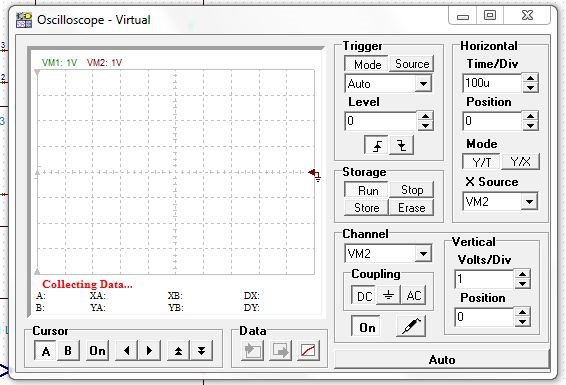

And when I ran it, there's nothing

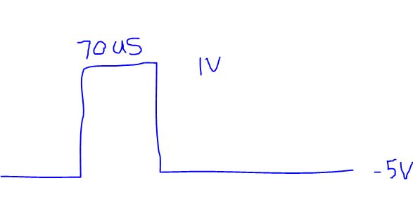

I also tried setting DC level to 1V and Amplitude to 5V, here's what I got:
Why can't I see anything on the scope when DC level is set to -5V?

Esme,
