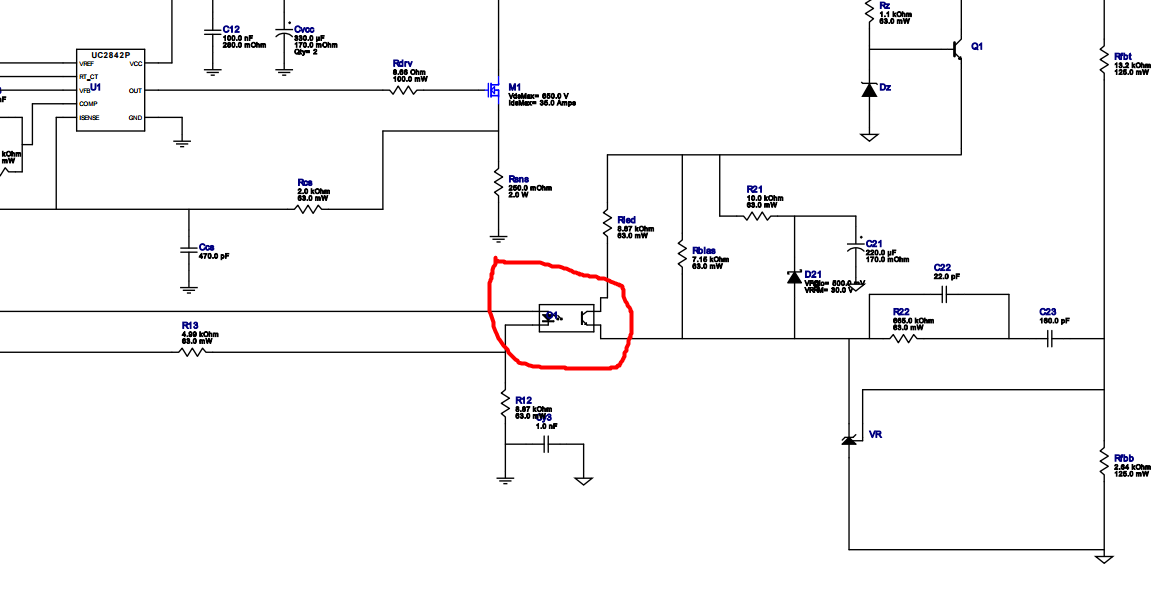

One customer reported the mistake when he designed with UC2842 webench model.
The initial thread is here.
The optical coupler was placed wrongly.
Please help to check it and correct the mistake in all related models.

Kening,
I have just been updated that there was a symbol issue with the opto-coupler. I believe that it has been resolved and should be corrected now.
