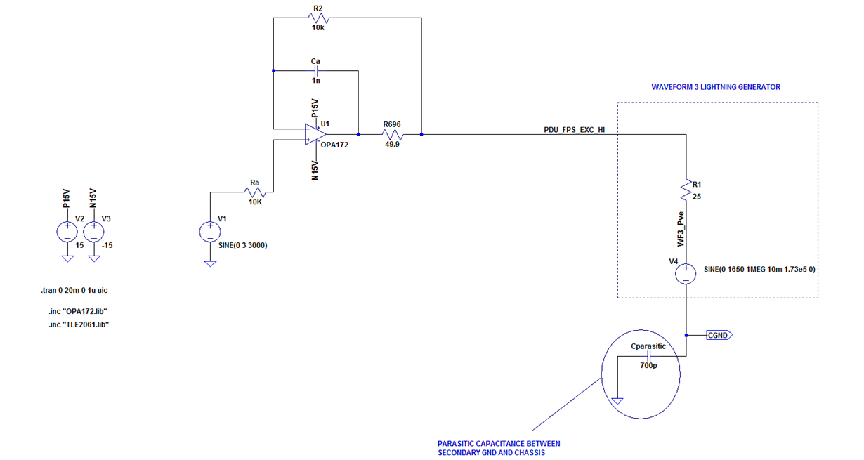

Hi All,
The datasheet of OPA172ID indicates that it has short circuit current (Isc) of +-75 mA. However during a lightning transient condition, we have a situation where the output pin of OPA172ID may see a transient current of the order of 7A peak without any external protection. Will the IC withstand a damped transient current (1Mhz frequency) with 7A peak current?

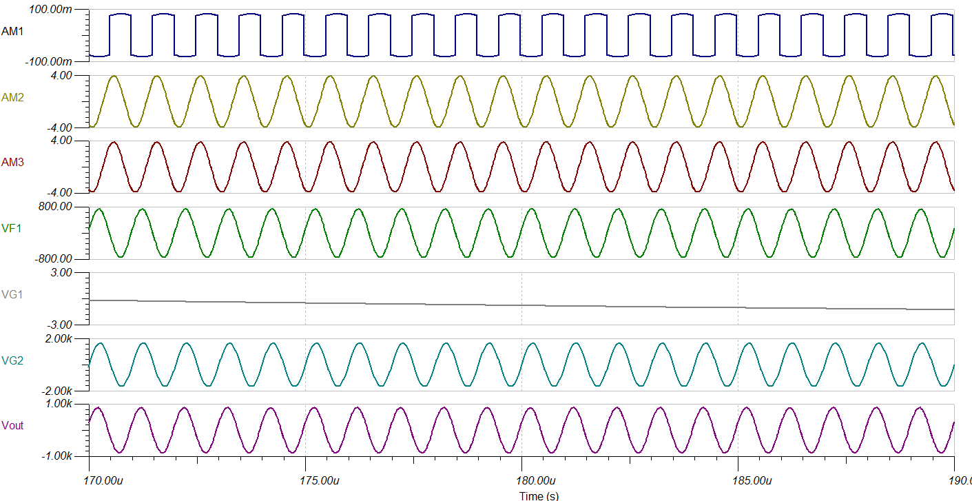

We are facing problems in getting the simulation working with OPA172 for this lightning transient simulation case. However the same circuit simulation runs when simulated with TLE2061. Looks like there is a problem with OPA172 spice model. We need your help with this.
Note: We are using LTSPICE for running the simulations. I am able to only insert picture but unable to send simulation files. I can share it if any mail ID is provided. Kindly do the needful.
