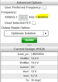

Is it possible to achieve using the LM25085?
Webench simulation could not be the operating frequency to 600kHz.
Could you give me your advice?

  • Hi Yusuke-san,
    In your customer's design case (Vin=12.4-19.5V, Vout=12, Iout=6.7A), the max frequency in WEBENCH is being limited by the estimated power dissipation in the FET selection, not the Ton_min specification.
    You can 'trick' WEBENCH into creating a higher frequency design by lowering the Ta (ambient temperature), but your customer needs to take care in the thermal management to make sure the FET and IC do not overheat.
