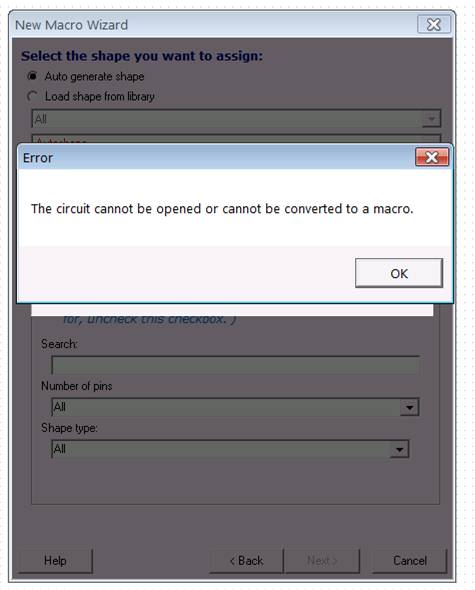

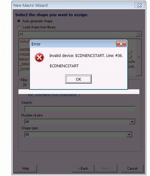

My customer tries to import PSpice model to TINA-TI and got errors below. Could you tell me what can be wrong in here?
He uses model from here:
LM74610-Q1 PSpice Transient Model
Thank you, Mike

HI Mikhail,
Please see the TINA-TI model attached. I have exported it from WEBENCH.
