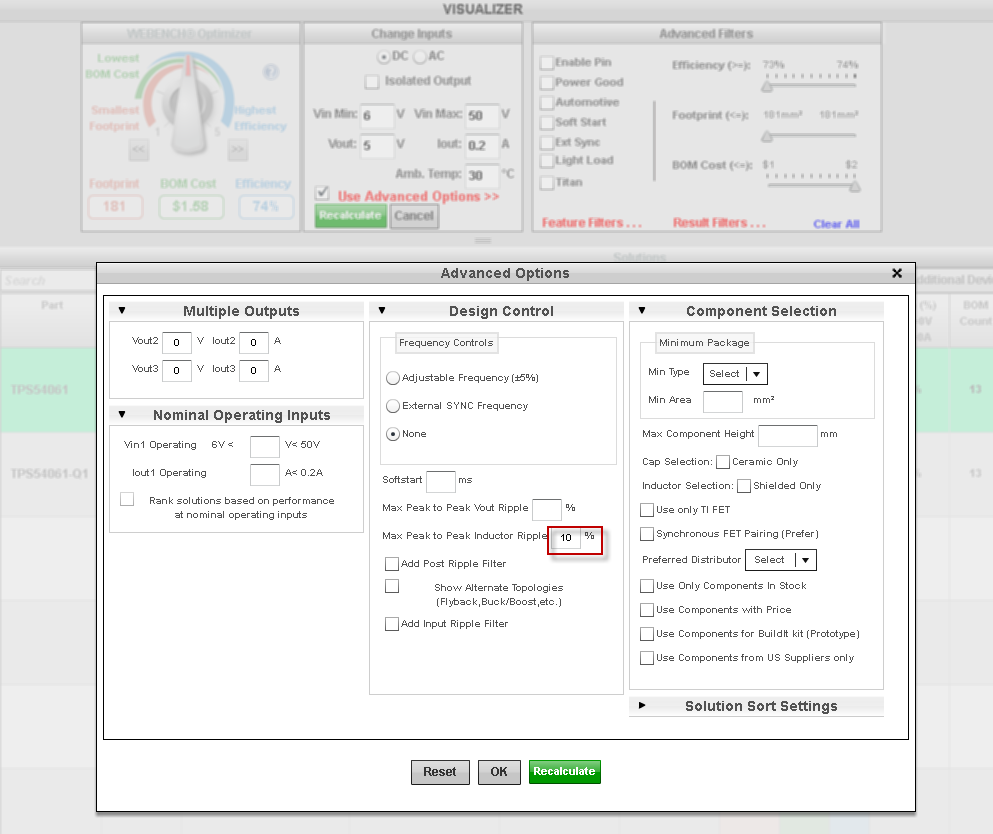

I tried to create a design in WB Vin = 6 to 50 V, Vout = 5 V, Iout = 200mA. WB will not create a design as it calculates Iou/Isw = 2.6744 A which is above the current limit. It is probably picking too small an inductor value and / or too low switching frequency causing too high peak ripple current. I am trying to check a customer compensation network issue and they need urgent support. Can this be fixed quickly?
