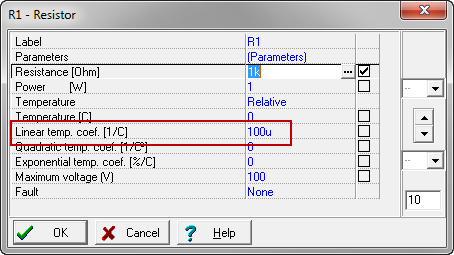

How do I set the resistor parameters for a standard +100ppm/ºC or -1300ppm/ºC resistor in TINA please?
I understand it's the linear temperature coefficient field, but I'm not sure/want to check that writing 0.025 or 25m means +250ppm with regard to the input value 1/C.
Also, for a reasonably/sufficiently realistic interpretation of what would occur using real components over a specific
temperature range, can I leave the quadratic and exponential fields as "0"?  The help says you can leave the latter as "0."

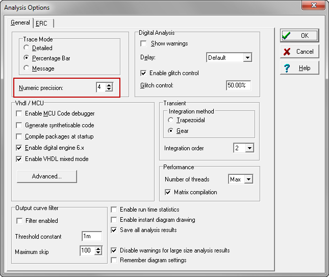

(Aside, is there a way of modifying the settings to get the DC results table to show "trivialities" like 1.007V, rather than
1V, so long as the value doesn't exceed 1.999V, please?)
