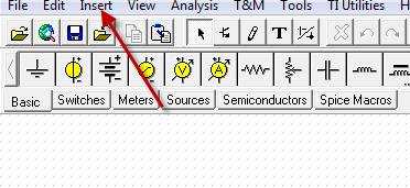

Maybe a stupid question but how do you load a Tina TI Spice model in Tina?  In that case I assume I just have the device and can create my own schematic around.

    Good questions. The .zip file contains a .TSM file which is what we call a macro file. This is a self contained file that holds the symbol information, connectivity, and the spice model for simulation. To use this file, simply start up TINA-TI and select the Insert-->Macro... feature from the top bar.
    This will open a navigation window so that you can navigate to the .TSM file on your computer. It will then be placed into the schematic window.
    The additional files were originally used to import devices into the menu system of TINA-TI. The older methodology is not used currently and we prefer to use the .TSM file since it has all of the information needed.
