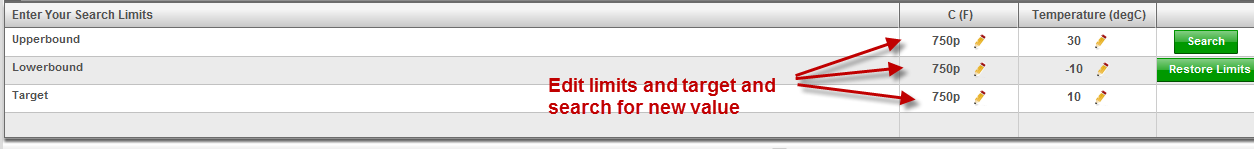

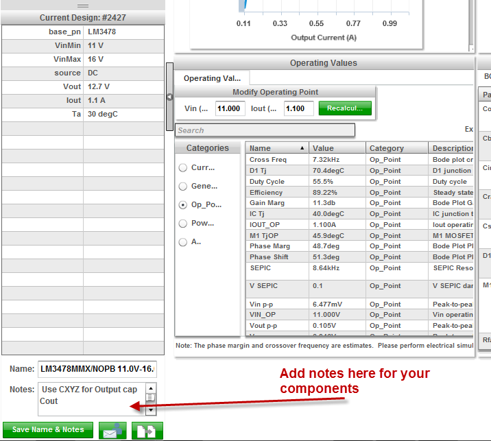

    If you are not updating the value of the component being used, you can add notes to the design that state the "stocked" component you will be using as a replacement. If you are changing the component value slightly, we still allow the editing of the bounds on the component values. Simply edit the upper and lower bounds and find a suitable value (the same as the stocked part) and use it with the note added.
    Adding notes:
    Updating limits for components:
