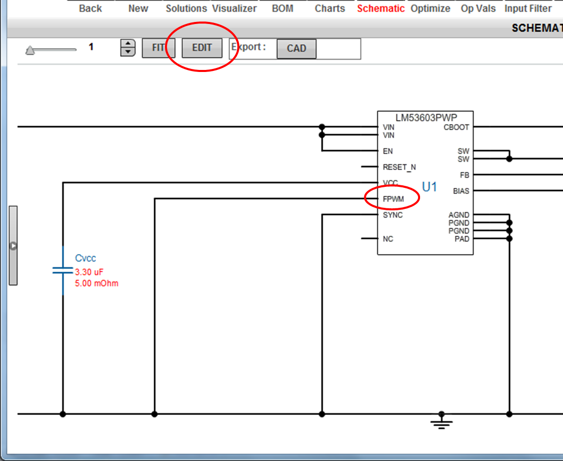

I'd like to perform simulation of LM536035-Q1 in FPWM mode on the Webench, but it seems that only AUTO mode is available currently. How can I perform the simulation in FPWM mode?

Gupta-san,
No, what I refer to is Webench. When I choose the device LM536035-Q1, the schematic shows AUTO mode because its FPWM pin is tied to GND. But if I could edit the schematic, I wonder whether I might be able to change the connection of the FPWM pin, but actually the EDIT button on the Webench won't work. That's the issue.

Gupta-san,
What I'd like to get through Webench is an efficiency curve - efficiency vs. output current in FPWM mode.

Hi Yokota-san,
The edit button that you showed in the previous image was for online spice simulation only.It should not be used if you are interested in Efficiency calculations in a different regime.
For this device, we do not have the FPWM option available in WEBENCH (the part still supports this, it is just a tool limitation), and also it is not modeled in the efficiency calculations. Only the CCM/PFM efficiency is modeled.
