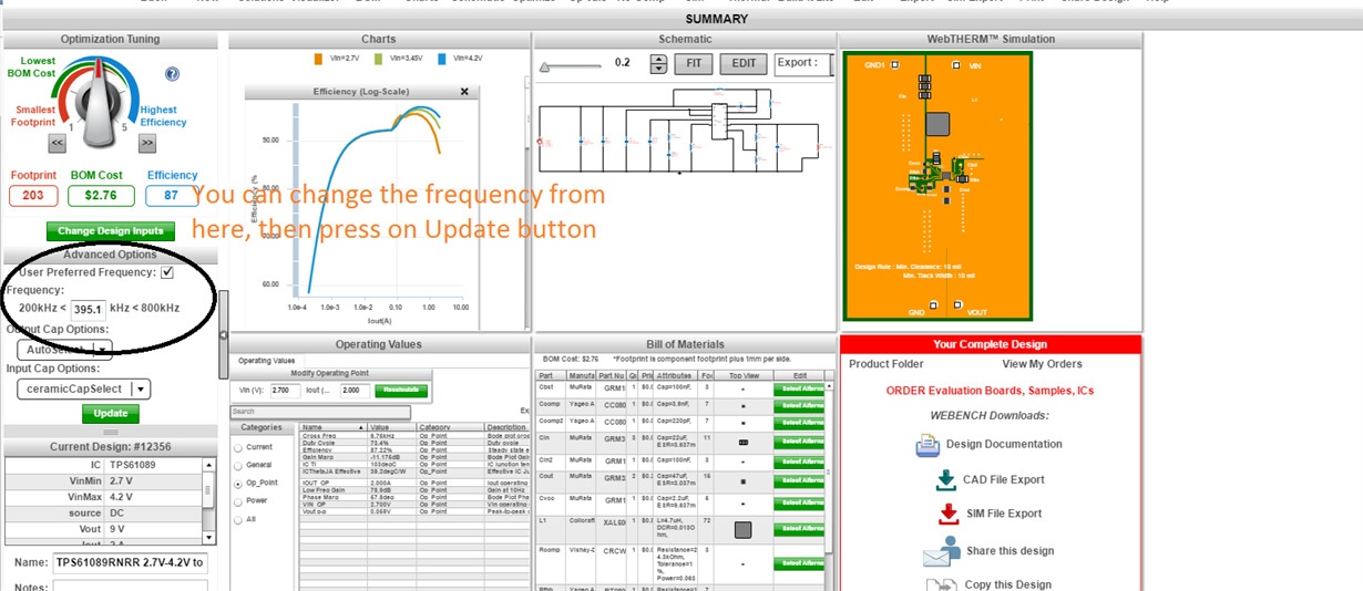

I was not able to set the switching frequency in the WEBENCH.
Is it possible to choose the switching frequency in the WEBENCH?How?

You should be able to do this by going to the advanced options on the left side of the design dashboard window.
I am attaching a snapshot for your reference
Can you also tell me the operating condition for your design - Vinmin, Vinmax, Vout , Iout and Ta so that I can also look at it.
