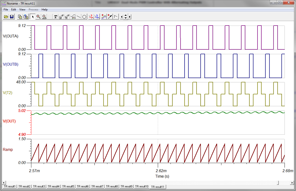

    I’m wondering if you can supply a minimalist circuit that shows the A & B outputs can be active & out of phase. I cannot provide a circuit snapshot sine it is classified.
    The best I can do is just to tell you that the 25037 is used in a push-pull configuration.  In the simulation circuit using Microcap, only one of the two output drives is working and I get nothing at the ramp node.

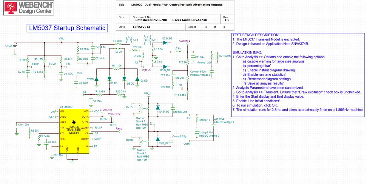

    We do not currently have Micro-cap for use and do not support it directly, other than providing the PSpice models that can import into it. I can provide the circuit and waveforms that the TINA-TI simulation show for the EVM design. They are shown below.
    Circuit for the EVM:
    Zoomed waveforms from simulation:
    I hope this information helps.
