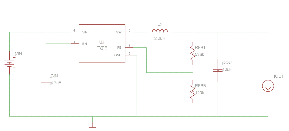

i can not use the schematisch from webench in eagle. I have so many errors.
Find my schematic attachedwebench_schematic_exchange_design_4894260_2_Eagle.zip

Thank you for the support using Ti's WEBENCH tool. I took a look of your attached file and i was able to import the schematic in EAGLE 7.7.0.
I have included the converted schematic here as well.
Please note that there is a readme.txt provides the instructions on how to import the schematic, library or PCB. Please take a look and let us know if you still have trouble with importing the schematic.
Hi Huguette,
The .src file is a separate file and it's contained in the same export zipped file.
Run the script from the library window and save the library file as " AcceleratedDesigns_Lib.lbr" where the schematic looked for this library name.
Go the schematic window, select Library from the tool bar and select Update; choose the newly imported library and sync each part.
Let me know if you still have trouble sync. up the library to the schematic which I have included here:
Thanks it works!!
