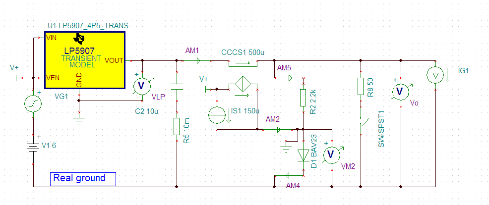

I found that GND pin current of LP5907 model is always 1 uA, doesn't change with load current as shown in the datasheet.
Furthermore if I raise GND pin from ckt ground with 680 mV battery, the LDO doesn't start, output is a false -0.5 mV.
I wanted to convert 4.5V chip into a 5.2V LDO by adding a biased diode between circuit ground and GND pin,
biased by a resistor from Vin or Vout whichever gives the best line load requlation.
Please find attached .dsn file. I run the latest TINA sw from Designsoft on Win 7 64bit.
Can you suggest a solution to sym this application of this LDO? I looked for this LDO type becasuse it has
the best noise data and price.
