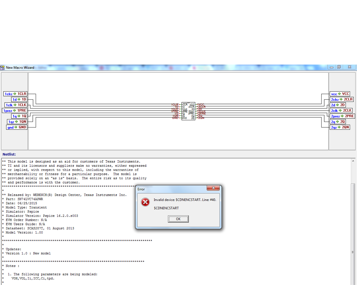

I got SN74LVC74APWR spiuce model & i am unable to add this to TINA.
I have attached the screenshot of error for your reference. please suggest

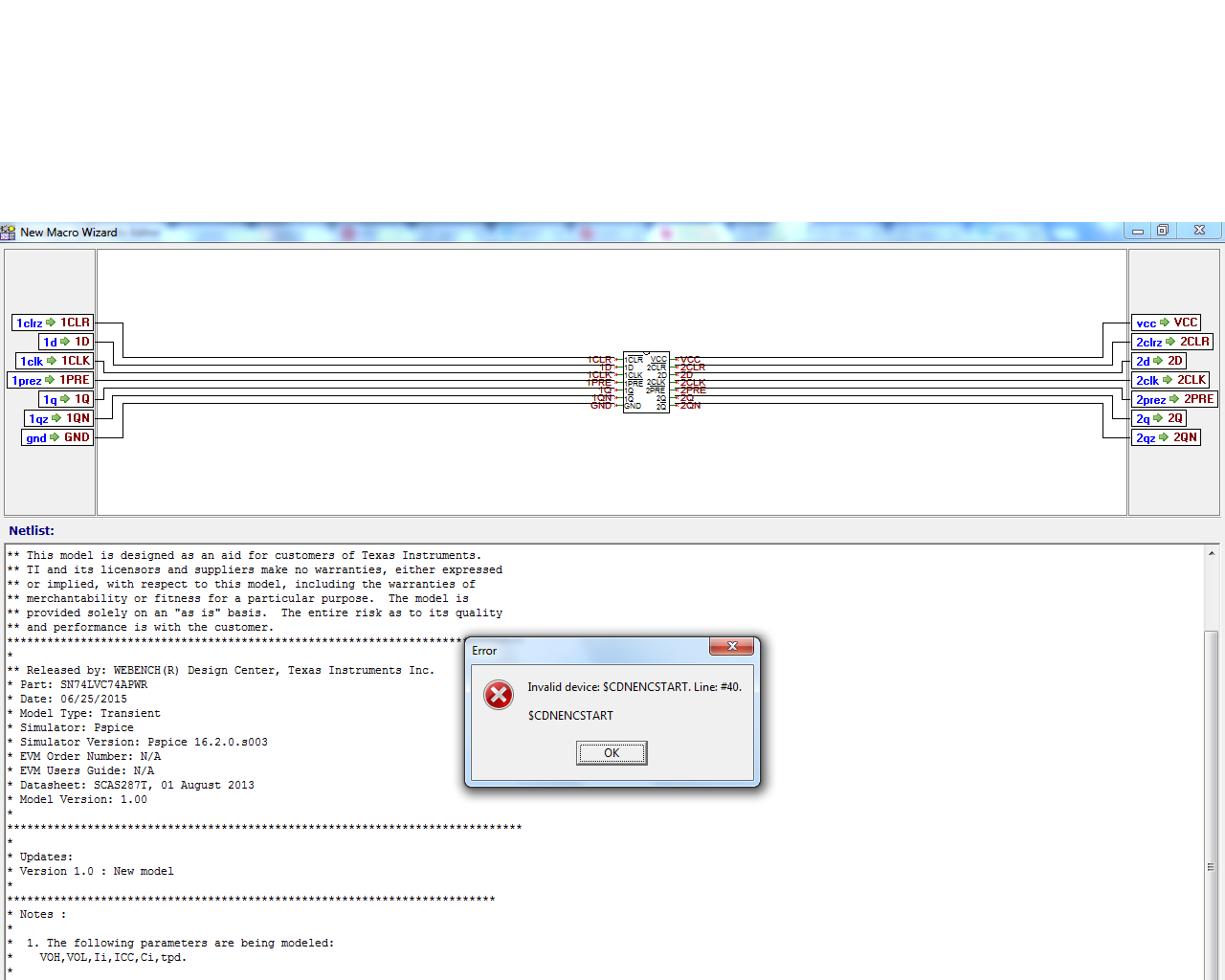

Hi Srinivas,
The PSpice model in the product folder is encrypted and can only be used in PSpice version 16.2 and above. In order to use the model in TINA-TI, you would need the unencrypted PSpice model. You can follow the directions in the FAQ for how to obtain the unencrypted model:
See the section on Getting the unencrypted model.
