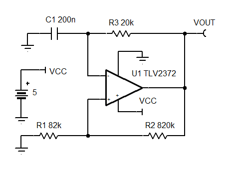

Dear all.
I have any question for schmitt trigger oscillator using TLV2372.
non-inverting input is 82kohm & 820kohm, inverting input is 20k & 200nF and Vcc is 5V.
Tina simulation is good ocillation but of the actual boards, 15 out of 50 units do not work.
it work when 10V & 4Mohm are connected at 820kohm to insert divider voltage to non inverting input.
when this point is added, simulation doesn't work.
my question are below
1) is it possible to use resistance to solve this problem?
2) what is the fundamental problem?
3) Can a oscillation waveform change depending on temperature?
