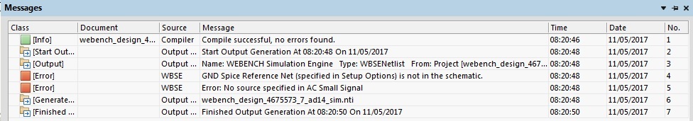

  • Pradeep,
    Altium version 17.0.10, 1.0.0.65
    There are two issues here. The original file that I am trying to simulate is contained in the zip Fred (03-05-2017 09-26-21).zip, this runs for one second and then aborts, restarts for one second and then aborts again, repeatedly.
    The second issue is with a TI WEBENCH generated circuit that reports as per the image below, the design is found in webench_design_4675573_7_ad14_sim (11-05-2017 08-30-55).zip. This has generated an error message Error: .include file "pspice://../MAIN_BLOCK_CIRCUIT.FILTER_STAGE_1_SIM.A1_S1.WB_AMPLIFIER.enl" could not be opened.
    Martinwebench_design_4675573_7_ad14_sim (11-05-2017 08-30-55).zip;

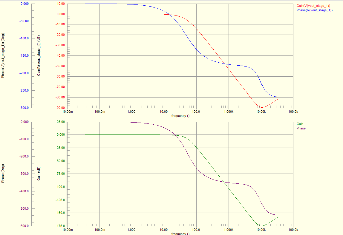

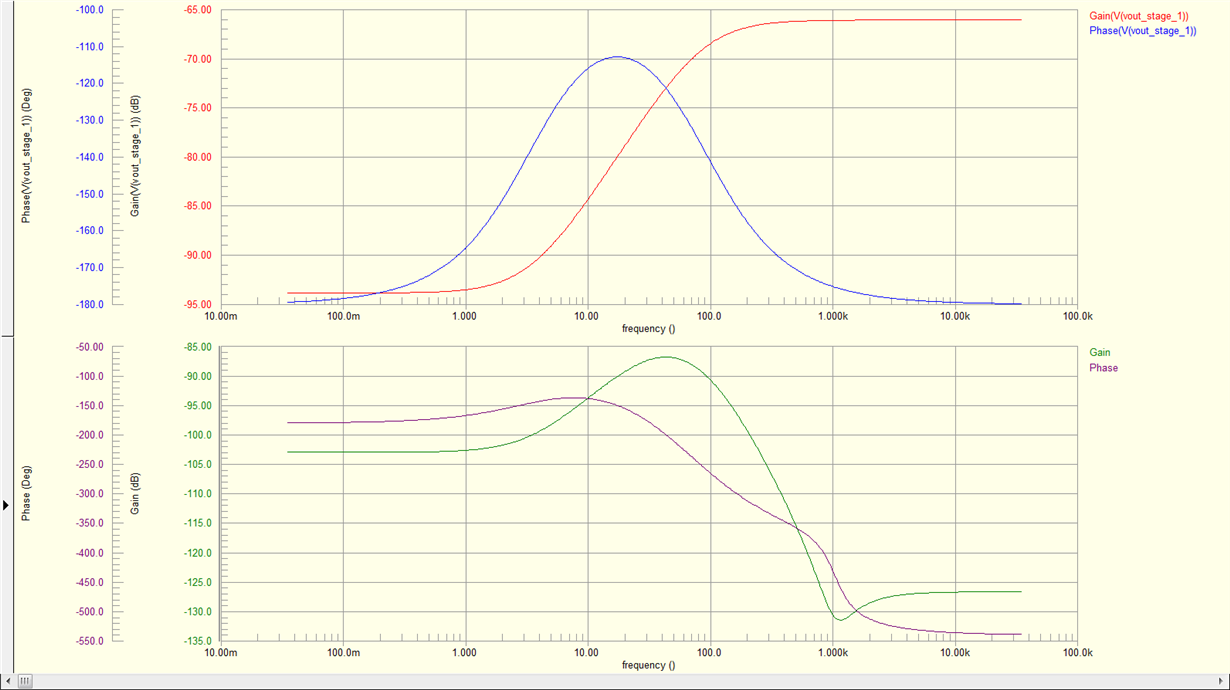

  • Martin,
    Please find attached the WEBENCH exported design for simulating closed loop frequency response. Its working fine.
    webench_design_4675573_7_ad14_sim (5-11-2017 12-58-09 AM).zip
    Here is the output.
    Pradeep

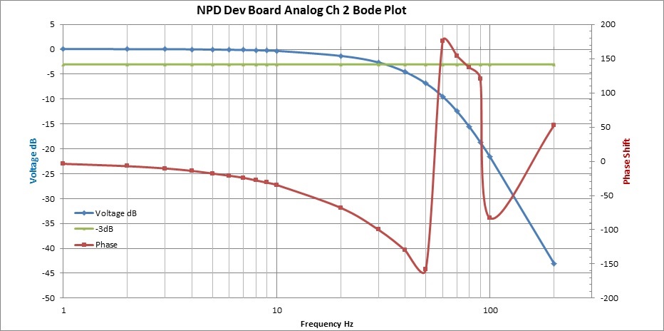

  • Pradeep,
    not sure how much you know about electronics but the output is over 100dB down for a unity gain amplifier configuration, this is far from correct. We have done bench testing and the plot below represents real world measurements.
    here is a plot from TI WEBENCH online for the same circuit;
    and an example from FilterPro;

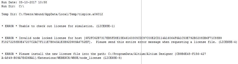

  • Version:  4.3.0b3
    Host:     NPD-CAD18.penlon.co.uk
    CPU:      2 cores (User)
    Mode:     64bit
    Platform: w64
    Run Date: 05-11-2017 11:10
    Run Dir:  C:\
    Temp Dir: C:/Users/mbund/AppData/Local/Temp/tispice.a04148
    * ERROR * Unable to check out license for simulation. (LICENSE-1)
    * ERROR * Invalid node locked license for host [6F2FC62B7317EB5FD8E15E46163305CDC97C00E2CD114A16064F6A1C53E792B0208DB6F71C88B9F18272258B3E47207C2AC7F111E7B840A1E3B92D989A6752EF].  Please send this entire error message when requesting a license file. (LICENSE-4)
    * ERROR * Please install the new license file into the path: C:/ProgramData/Altium/Altium Designer {CB9B6E48-F156-427A-A849-B09A7E6D6BA1}/Extensions/WEBENCH/WBSE/node_license (LICENSE-5)
    Simulation: FAIL
    cpu(000:00:00.109) wall(000:00:00.445) - Total
    Pradeep,
    after running WEBENCH for a single simulation, Altium/WEBENCH has overwritten the Node_Licence file and the simulator will not run.
    I have copied the node licence again to C:\ProgramData\Altium\Altium Designer {CB9B6E48-xxxxxxxxxxxxxxx}\Extensions\WEBENCH\WBSE and the following error was reported;
    error log attached.
    Martin
  • Martin,
    I am still not able to reproduce the issues at my end on licensing. As you have confirmed today, that you are able to run simulation without any issues. So that's good news.
    Regarding the results, there was an issue with the AC source connection getting swapped. If you see the netlist (nti) file you will notice the Vin and 0 are not as we see in schematic.
    Vsignal 0 VIn  DC 2.5 SIN(2.5 1 1000 0 0) AC 1 0  (Wrong)
    As  per the schematic it should be
    Vsignal VIn 0  DC 2.5 SIN(2.5 1 1000 0 0) AC 1 0  (Correct)
    The issue was with port map of this AC source, that i have fixed. Please find attached the design and here are the results.
     webench_design_4675573_7_ad14_sim (5-17-2017 1-58-43 PM).zip
    Pradeep
  • In this reply when i said its working fine, i meant that there are no error messages as the issue was with running the simulation successfully. without any netlist errors. However the results are wrong due to Vsignal source pins getting swapped. Once we fix the pin mapping issue the results are correct.
