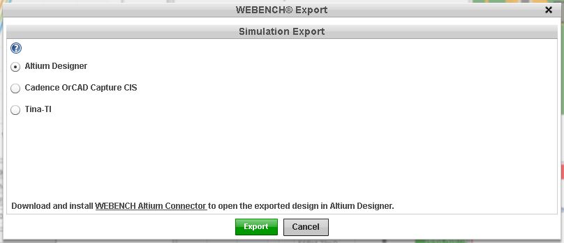

Hi Wojciech,
We have enabled Sim Export option for this part in WEBENCH. So now you can create and simulate your design on WEBENCH and then export it to Altium using Sim Export option for this part. PFA below the images, which will help you through the Export procedure in Altium.
Thanks!!
Mahavir Jain.
